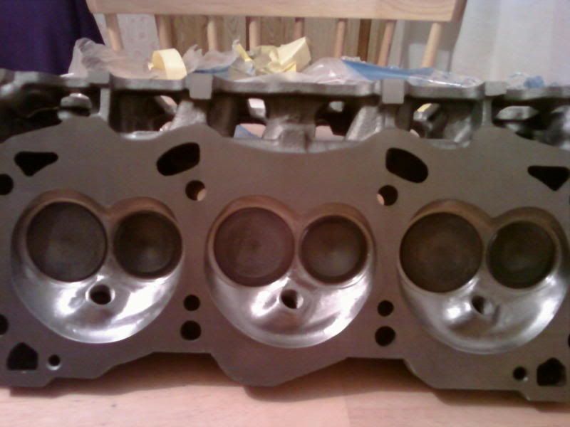

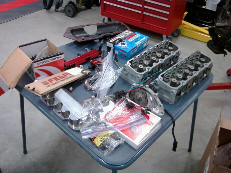

Picked up heads saturday that Luke on here did for me at Smyths...they are pretty tits.. Really nice job on them...
Would consider them between a vendors "stage2" and "Stage3" heads... which retail $1100 - $1600 ... i did supply the springs/retainers/locks/seals .. springs i had already collecting dust for two years, and other parts were cheap.. final cost came out to be acceptable and saved quite a bit of $
Should help out quite a bit in the flow department for the turdbo ... gotta start ordering more parts ...

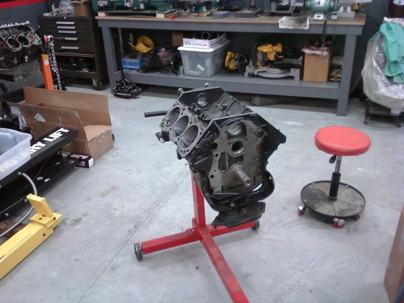

Crappy photo of one of the heads.. didn't go crazy on pics as people like to nit pick about everything on how they can do better or blah blah does better..
It is nice having a set of heads that are not covered in oil and grime for once.

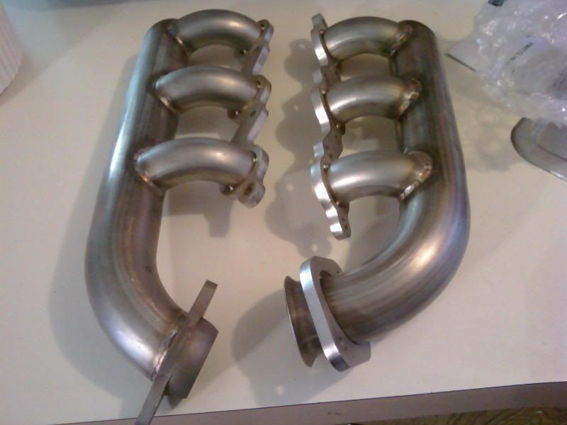

SS "power" logs came in today.. got them used, but never installed/ran saved about $100...
Having mustangboy ceramic coat these to go along with the other ceramic parts I have.. miss match in color black/silver but who cares...
Got my V6 Fbody intake manifolds also, they are nasty nasty nasty... Having him clean those also before I do any work on them and start putting motor together for test fitting of shits.. Once done ill have im powdercoat them..
I may have tubular headers made some day, but these have been used on ~500whp setups... so may not really have to.. depends on what i run and how i feel i guess.

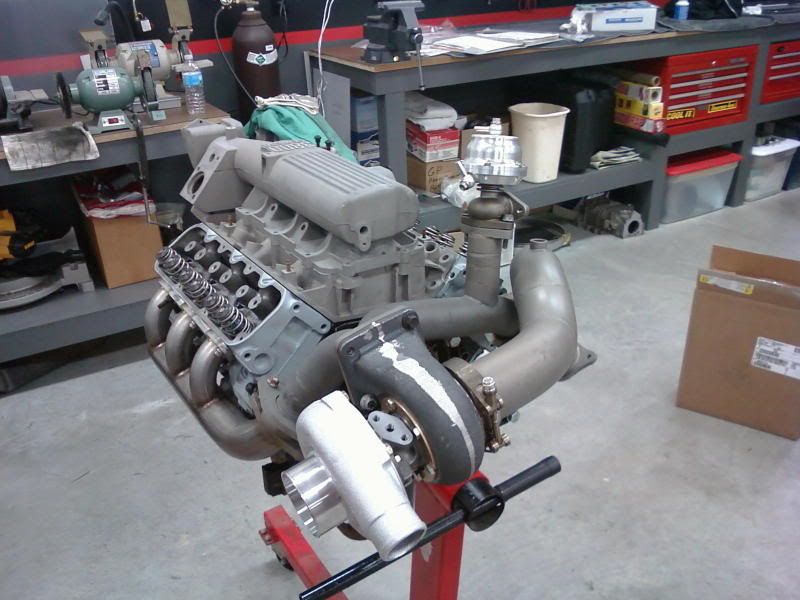

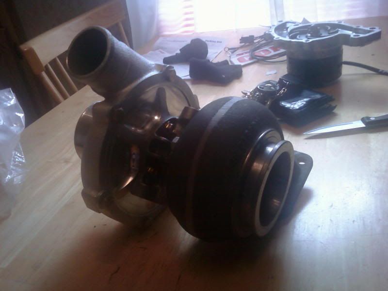

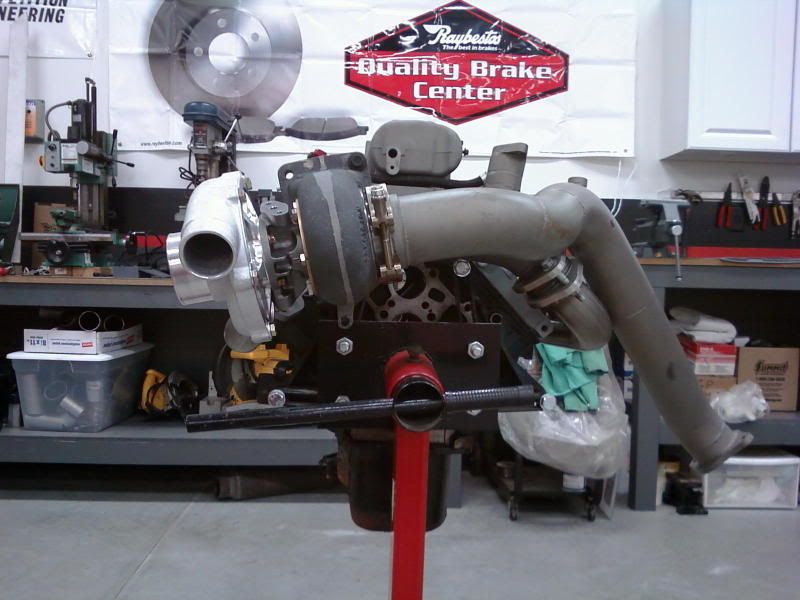

Just showed up
Now if my head gaskets ever show up this week, can finally piece this turd together. Then off to trying to build a trans. Can't decide if I want to get in on the group buy of a Quaife diff for a measly $1400+ .. Then to find a 1" chain setup for about the same... sigh..
More pics to come this weekend hopefully for anyone that really gives a shit.

stattama piece? looks good
grandmaGTP is offline   Reply With Quote
Old 01-23-2012, 01:19 PM   #52
jdredd
Posts: 1,673
jdredd is on a distinguished road
Yup.. thought about going bigger, but honestly this should produce enough to make me happy.
If I build another short block in the next year or so with all the good internal parts, I may upgrade to bigger one, but for a stock rebuilt short block this is good enough.

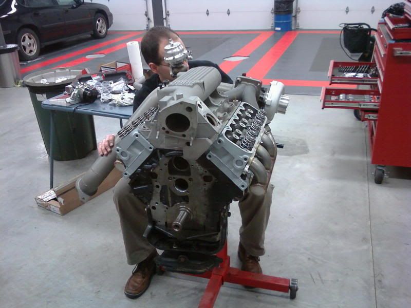

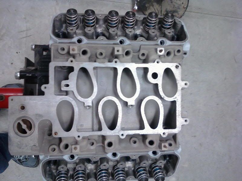

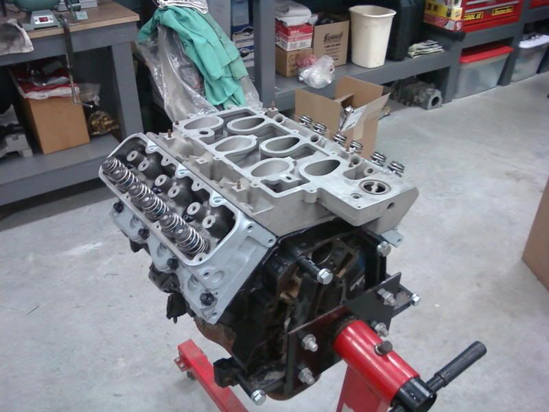

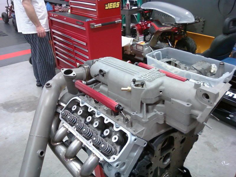

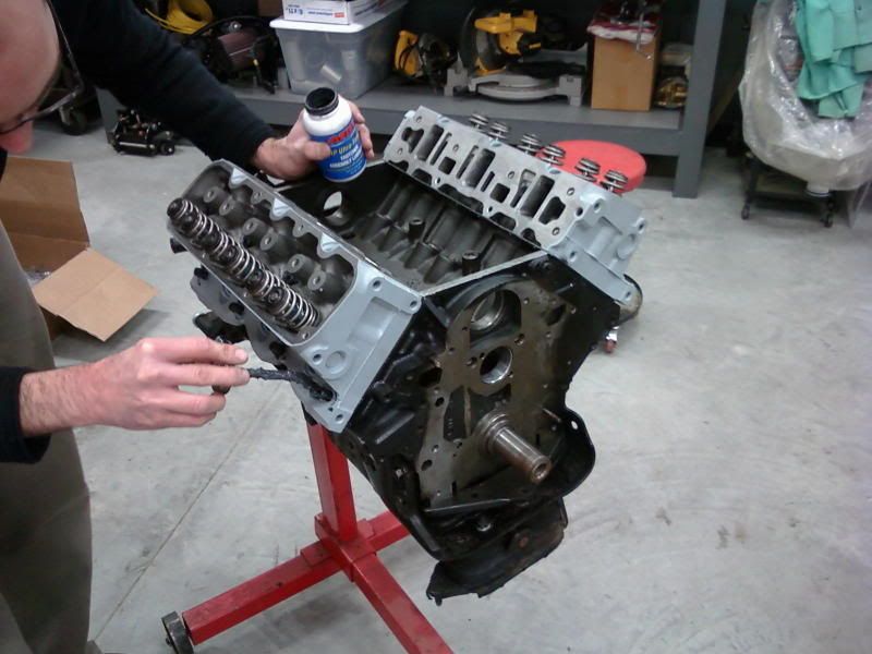

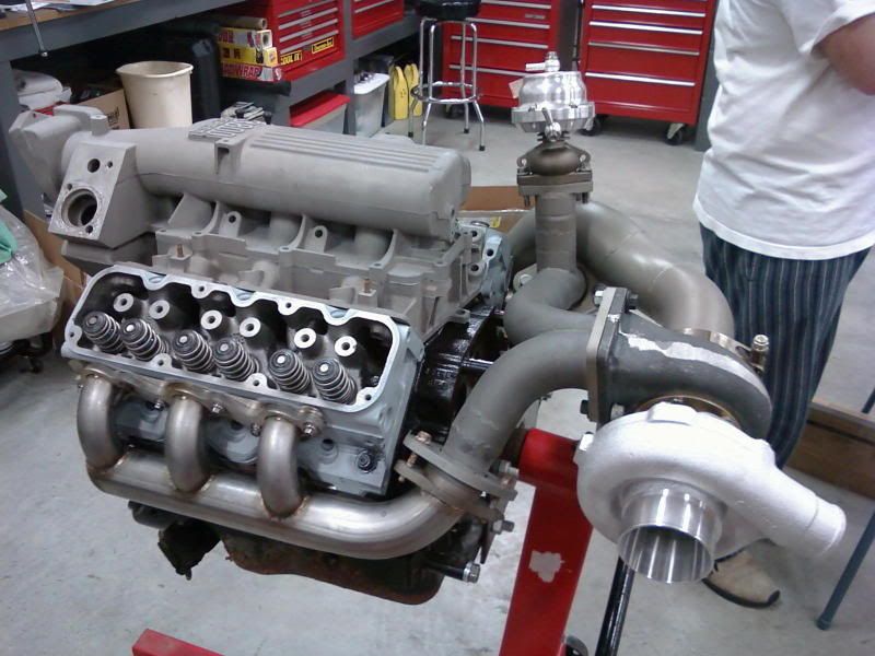

Well got to start on the motor some what.. got the heads on, but could not do much more after that. Ended up not having a tap big enough to plug the injector holes on the intake manifold, but we ended up putting on the exhaust parts and junk to mock it up and get an idea of the setup. Gonna fab up some more block off plates and crap and brackets. Need to find a stock LS1 TB as the one we had to use was modified and won't work for me.
So in 2 weeks or so, going back over to Sean's and we can continue and finish it up more. Fuel rails I need to change out fittings on the ends of the rails to make the hoses fit. Ill have more pics when more stuff happens. Was kinda neat to see how it will look finally. We didn't bother putting cam/lifters/blah in yet.
Ya I know, intake manifold is on backwards. Didn't notice till after I took pics.
Nothing was bolted so no biggie..
Shitty pic of Tyler staring it down and Sean in his PJ's? ..

What cross over is that?
Old 01-28-2012, 01:34 AM   #60
jdredd
Posts: 1,673
Stattama's ...
