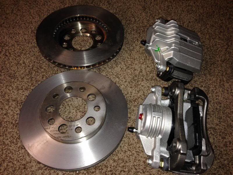

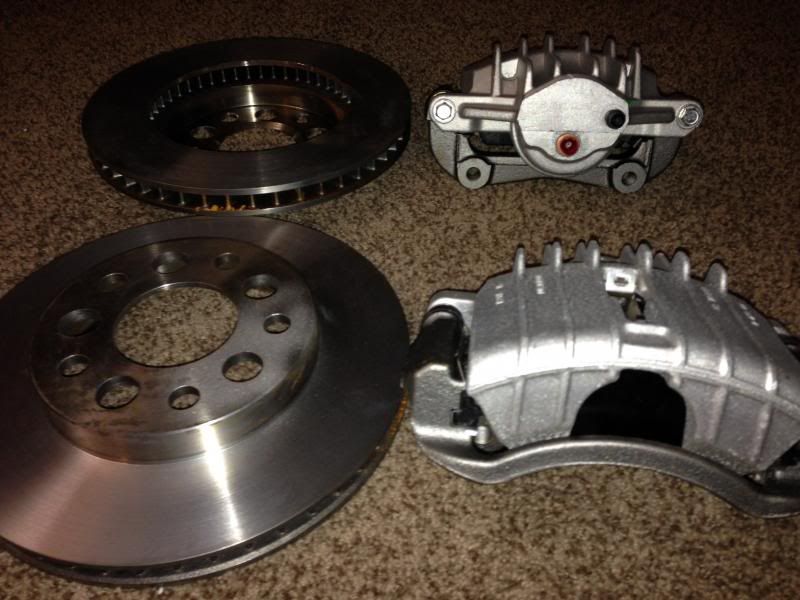

Picked up the aluminum grand am brakes. Not really any better then
stock, other then being a lot lighter.. so good enough for me :)
