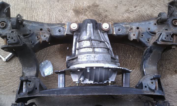

Started with mounting the diff like this ^^
Wat the rear mounts look like installed on the diff

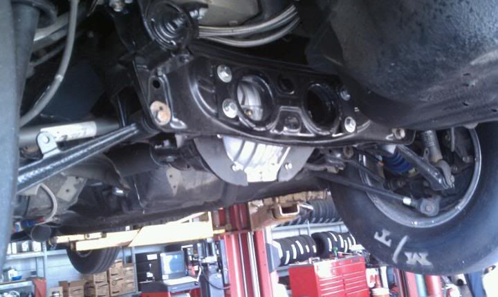

wat the diff lookes like installed in the subframe in the car....

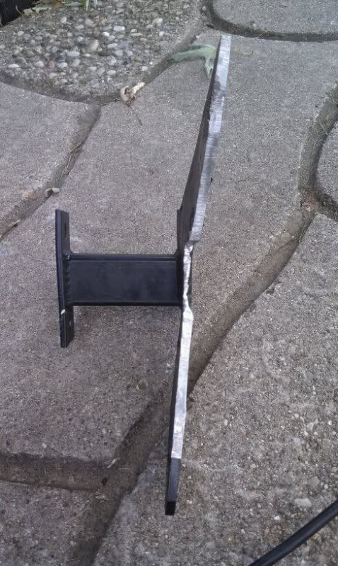

Wat one of the two rear mounts looks like after a few WOT pulls and launches. Both mounts got tweaked to hell and back hopefully being the cause of my rediculous vibration I was recieving. (found the bent mounts when pulling them off while trying to find a cause of the vibration)

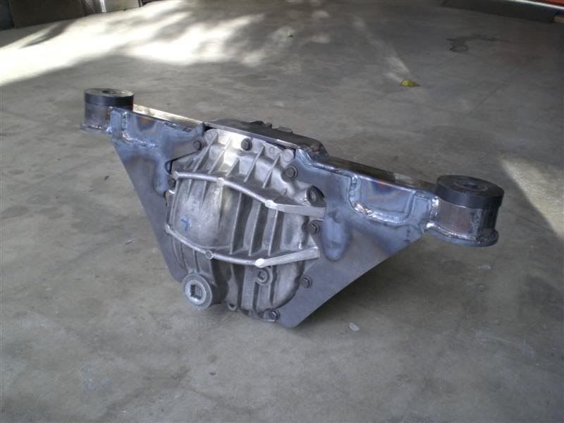

I'm thinking something similure to this would be stronger cause its one piece and has support horizontally as well as vertically.

You need to take a look at the explorer 8.8 cover.

Look on my photobucket, I used a cobra 8.8 and used the explorer mount. It was a much better option than using any of the other available covers (at least I think so).

Triangulation is going to be strongest. What thickness metal were you using? I would use 1/4" in a triangular design with added bracing if you wanted to use the stock mounts again. That mount has very little bracing and it's focused on the middle causing it to bend easily.

1/4", really. He's not building an earthmover. WTF.

BTW, I agree that the explorer cover seems like hte best choice. Strong; solid design; cheap.
