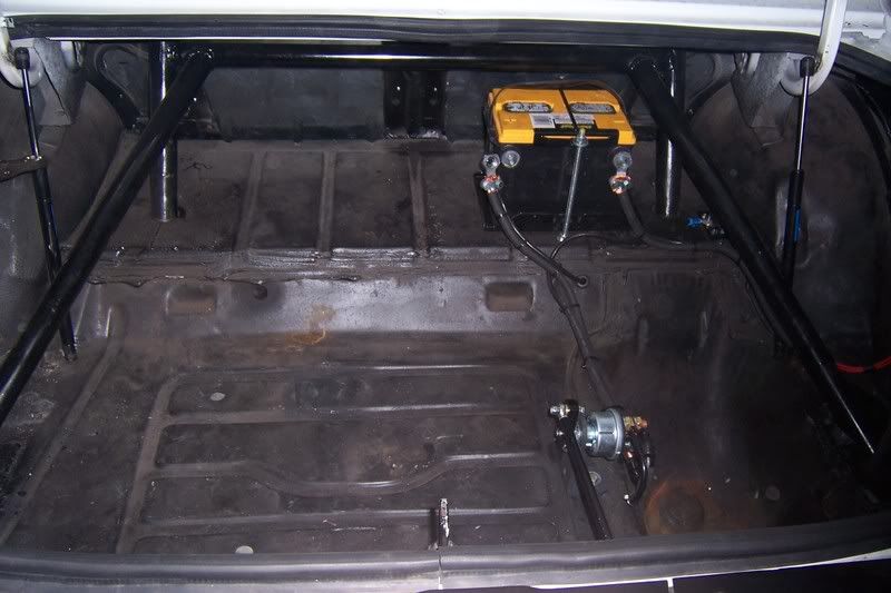

Hey guys I know this seems minial but I want to move my battery to the trunk.
What sort of line or cable am I going to need? Any fittings or whatever? If anyone has done this let me know what you need or how you did it.
thanks in advance.

I ran 1/0 I got from a welding supply company from the starter to a kill switch. then another 1/0 from the kill switch to the battery. I used crimp on ends from KOI. For the alternator, I ran a 6 gauge wire form the output to the battery directly. Every car is going to be different here. My alternator uses an excite wire to keep it charging. That excite wire is going to a 12 volt ignition source. All the power from the car comes off the starter (this is the factory setup. I kept it this way to keep it simple.) The fuel pump gets it's power right after the kill switch.
My setup works great. I have almost no voltage drop from the battery to the starter and no voltage drop from the alt. to the battery. The car shuts off everytime if the kill switch is activated.
Here is a pic of the trunk. The kill switch has a arm that goes to the outside of the car to keep it NHRA legal. The arm can be removed for normal street driving.
I like the welding cable. It is very flexible and has worked very well for me.
[email protected] with the v6

I'd use a 1/0 cable. Ground it to the chassis there. Use an already existing bolt hole (not some bullshti screw). Make sure the ground is very secure. Run that line to wherever your original battery cable was, and hook them together. There are cleaner ways, but I wouldn't recommend it for someone asking how to do it.
