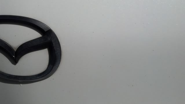

Thanks for the suggestions, fellas... Push let me know if you have some left over
Here's a pic, not the greatest (direct sunlight right after I washed it today) but all the specs are rail dust.

Yeah, their ABC system should take that right out and fix it permanently. I should be stopping by my parents sometime this week and I'll see if I have any left.

Iron-X. I've used it on multiple cars. I'm still suprised the original dealer didn't do a chemical bath on it to cleant his off.

Well I'm curious what the ABC system will pull out of the paint other than the iron rail dust... if it's good for other things too, I'll go that route.
So far I'm thinking;
Wash
ABC step 1
ABC step 2
ABC step 3
Wash
Clay
Wash
Polish (probably Griot's Garage Machine Polish 3 or 4, don't have too many fine scratches yet)
Paint sealant
Wax
