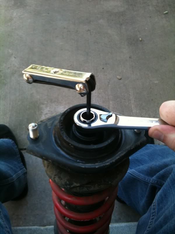

need help installing springs
long story short, i bought an s50 e30 saturday. the car has air suspension and of course half way home it blows a front bag so i had mike trailor it home. the bags are on kw coilover setup so i want to just quickly drop the strut, pull the bag, drop in the kw spring and tighten everything up. of course i cant get the top strut nut to back off without spinning the strut without an impact. so i wanted to see if anyone would be willing to lend me a hand? i need the car asap since i just sold my potiental daily tuesday. oh, and i apologize for the lack of punctuation but my cell sucks

use allen wrench to stop the shaft from spinning.

but how would i get an allen wrench in when my socket covers it. the nut is a bit below the body so i cant just use a wrench
http://www.i-club.com/forums/bay-are...essors-230055/

on my phone, what does the pass through look like?
