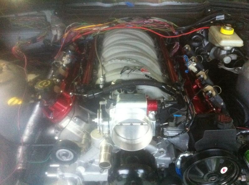

Well it starts but only runs for a second. Looks like VATS is still active. Is anyone around today that can remove it for me? 01 LS1 PCM

Wiring is almost complete. Having a buddy come over to remove VATS for me. I forgot that even though this PCM was tuned it was in a F-Body and retained VATS. Dhould have it on the ground in a few days!!!

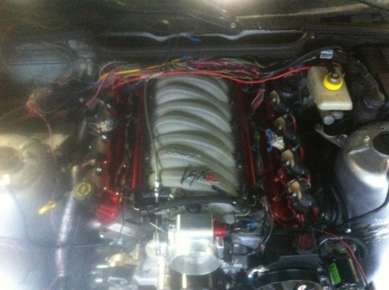

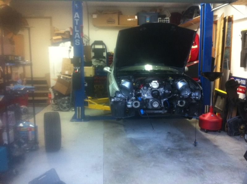

Why is your garage so foggy?
evil8 is offline   Reply With Quote
Old 09-22-2012, 08:53 AM   #50
Posts: 8,943
Yeah clean your lens on your phone lol
Love the project!

I wish I could. There is dust on the back side of the lense.

It's alive!! Big thanks to Dave Blundell for stopping by this morning to pull VATS off foe me.

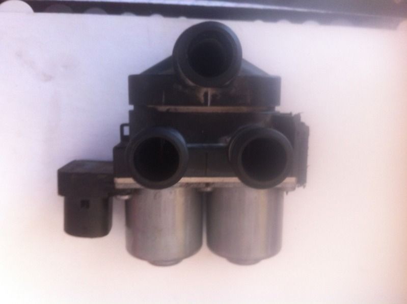

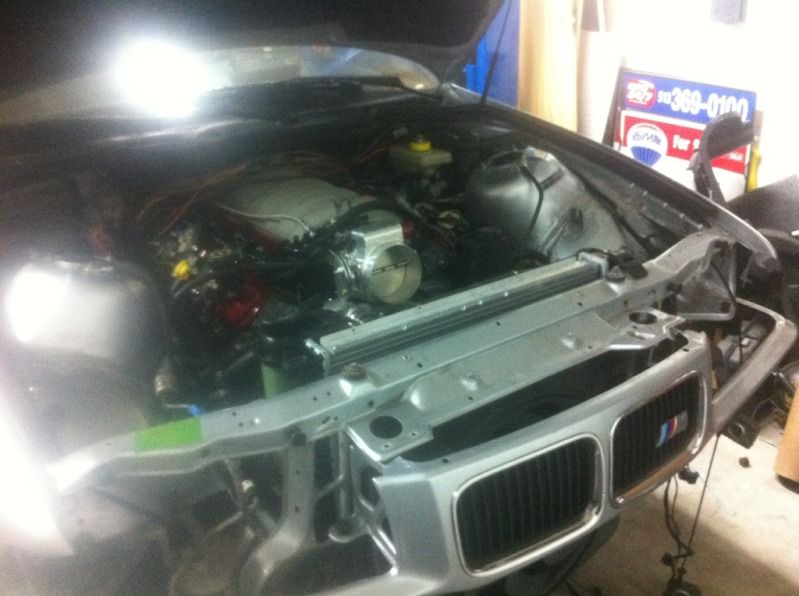

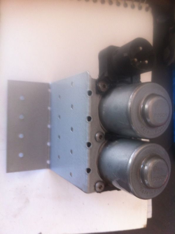

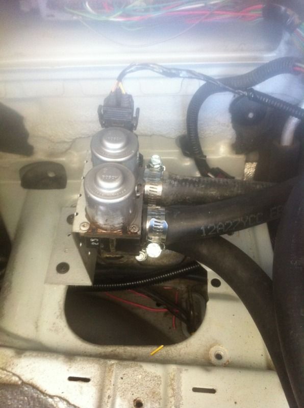

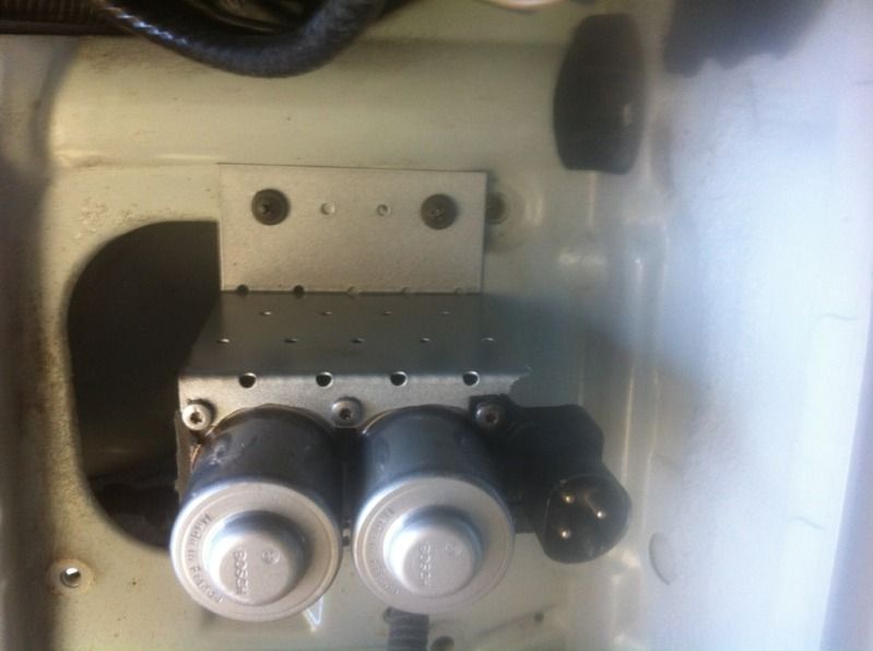

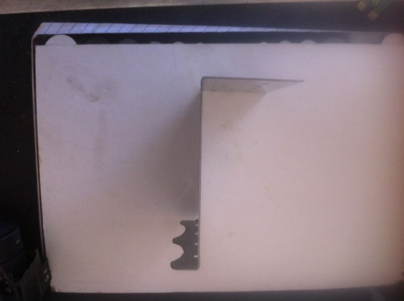

Got the heater control valve relocated and made a custom mounting bracket for it, Seems to work great. New OEM radiator and all the heater hoses are on. Filled it with coolant and brought it up to temp. The JTR sight window fitting works awesome. Thanks Mike!
Cut off the mounting bracket.

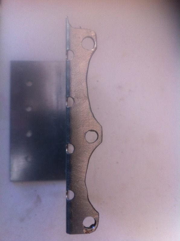

Picked up a piece of perforated sheet metal at the local hardware store and bent it to shape.
I rounded out the top of the bracket to fit around the two cylinders.
Next removed the 3 torx screws on the top/back of the valves. Drilled 3 holes in my bracket and checked fit. After that a coat of silver paint and we are good to go.
Ended the night with getting the front back in place.
shakenbake01 is offline   Reply With Quote
