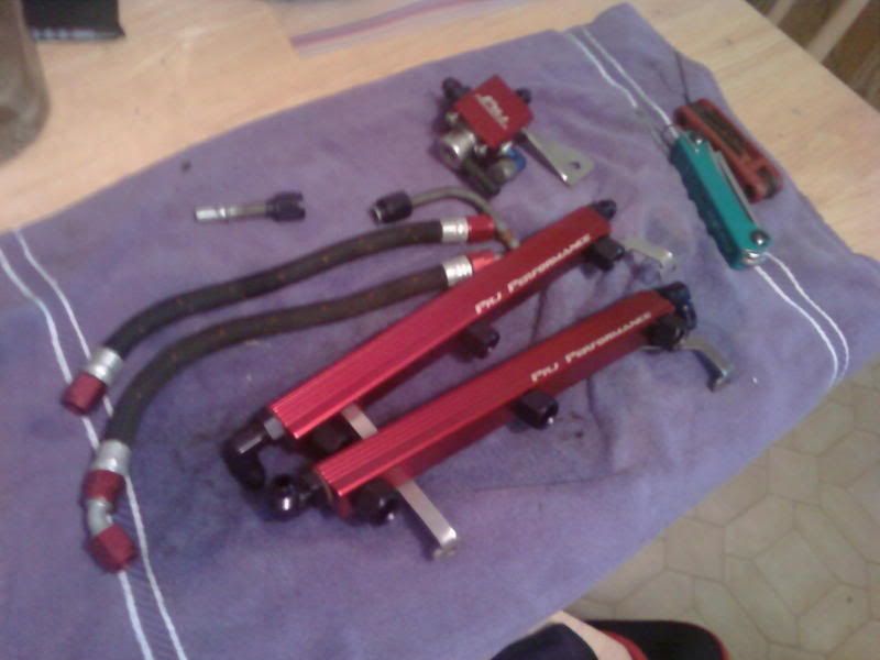

Was out in the shed to drop off a blower case I cleaned out... and stumbled on these that I totally forgot I even had...
Where pretty dirty.. pic of one dirty and one cleaned up rail..
All the parts..
Got these off the parts car... could not get the FPR out, one of the four bolts stripped, will
take care of that later..
