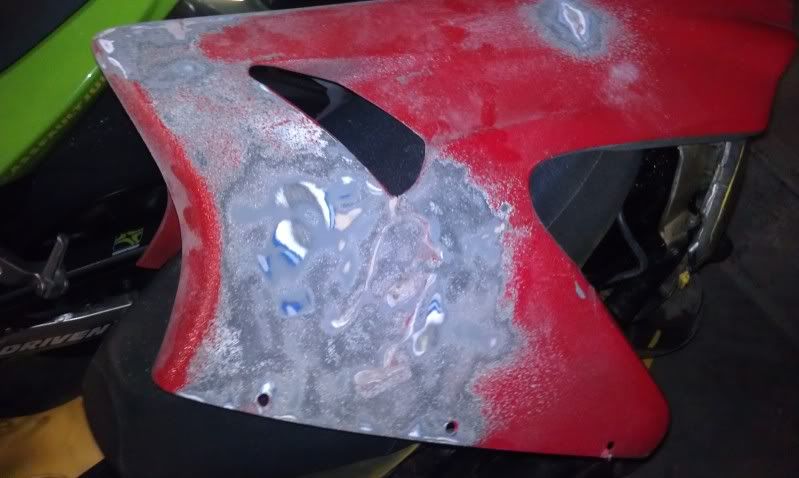

I did a little reading today and decided to go with some short fiber Bondo Glass. It seems that fiberglass mat/cloth is mainly to repair holes. I don't have any holes larger than 1/4" or so in diameter, so filler should work.
Sanded with the DA:

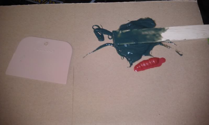

Mixing up the hardener and Bondo Glass:

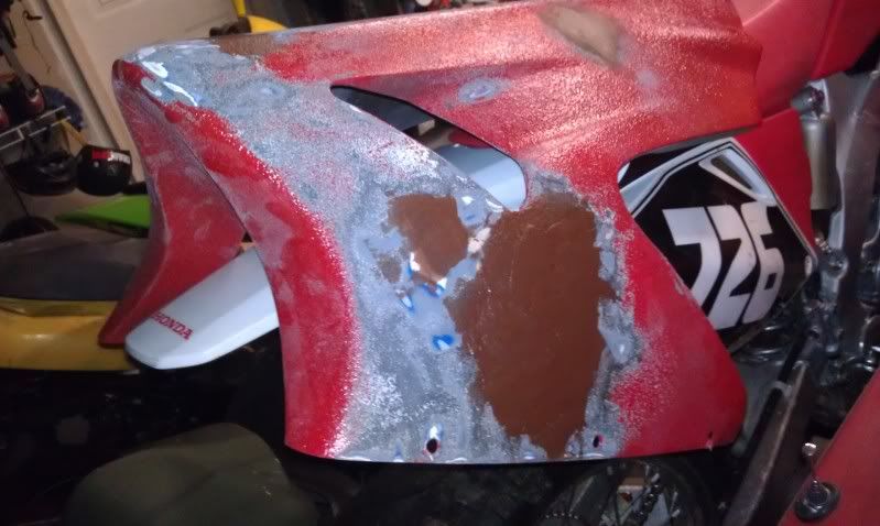

Curing for the next layer:
This wrinkle red paint is a bitch to sand, even with 60 grit on the DA. It takes FOREVER. I still have to sand the tank which is in wrinkle black and sand the rest of the lower (pictured above)
